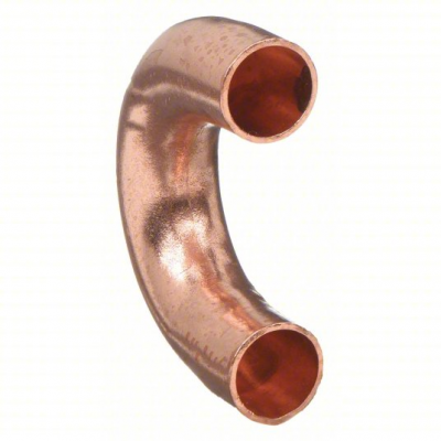

If i were doing the same thing to my own Ram ...
I would go to a plumbing place, like Home Depot
I would buy one of these
It would have to be the size of the heater hoses, that go through the firewall.
About 6" to a Foot away from the firewall,
i would cut those heater hoses.
the two hoses that are closest to the water pump, i would slip a couple of Water Hose Clamps over the 2 hose ends, the slip the hoses over the piece in the image & clamp them in place.
May sound strange, but that will keep the radiator goop out of the Heater core that is located under the dashboard.
After you flush the radiator & you are happy with it.
Then you can remove the U shaped copper piece.
Then replace the curved piece with two 4" pieces of straight copper.
Then connect the hoses into the sections of pipe, using clamps.
That way the water is flowing as it was before you started.
and you have not contaminated the HVAC System
And, it might be a smart idea to back-flush the heater core separately, before reconnecting everything back.
I love the detailed response. I also have no idea what you're talking about in this post lol. What is the firewall? Why would a brass pipe prevent water flow compared to a hose? Why would I then replace the curved pipe with straight pipe? The sum total of my working on cars is doing an oil change for reference. I'm happy to learn, but this went way over my head I admit.

First answer is the Firewall is the metal wall between the Engine & your Dash Board
It is directly in below the front windshield.
In the engine area, under the hood
There are 2 hoses that carry water, you can not see them with the Engine Cover on top of the engine
Those two hoses pass through the firewall, they carry heated water to the Heater that is hidden underneath the dash board.
If you take those 2 hoses apart at the firewall, it is a knuckle banger,
so if you cut the hoses away from the firewall, it makes the job easier.
The whole reason for disconnecting the hoses from the firewall area, it keeps an crudy water from entering the heater inside of the cab.

Further to GTyankee's explanation; the heater core will behave like a filter on the coolant line and  will become clogged by all the chunks of yuck in the coolant.
This is most likely not a risk but inevitable, due to the condition of your coolant.
Once the heater core becomes even partially clogged, this condition will compromise the operation of heating in the cab of your truck.
Clogged heater cores are relatively common with older vehicles, even without a peasoup mix in the coolant line.
The idea of removing the heater core from the coolant line with a bypass pipe, before beginning the cleaning and flushing is a great idea and may save the cost and grief associated with replacing it entirely.

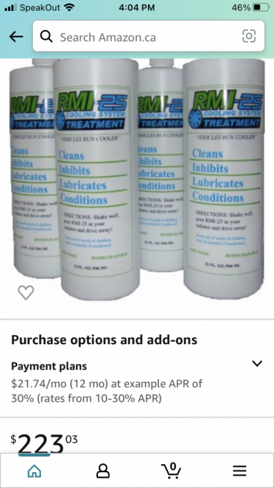

Sounds like this guy is going the dealer route, maybe it will work, for future guys, rmi 25 is built for this, it takes anything clogging your cooling system and turns it to slime and deposits it overflow tank where it is trapped. Google rmi25 fixes dex cool damage see if some of the pics are still out there. You need do nothing, put 32 ounces of rmi 25 in and fill with distilled water no mater how low the fluid level was, and drive 500 miles. You will see for yourself, when you remove the cap, it will look new and all of those clogs will be gone. It is safe and non toxic and slow working, which is what you want. Then it is safe to use 24/7 so it doesnt happen again. I don't really think there is great benefit to clean systems, but once it goes wrong this is the stuff.
RMI-25 Works While You Drive​
  • CLEANS – radiators, engine blocks, heater cores, hoses…the complete system
  • INHIBITS – rust, build-up of mineral deposits, cavitation erosion, electrolysis and pitting
  • LUBRICATES – thermostats, water pump seals, and heater controls
  • CONDITIONS – improves heat transfer
  • STABILIZES – contains a pH stabilizer for acid-alkaline balance
  • FLUSHES – power flushes in combination with your water pump while you drive
  • DETECTS LEAKS – contains a leak detector which pinpoints leaks under a black fluorescent lamp

Has anybody found RMI-25 in Canada?
I've looked a couple times for it up here,and have never found it.
Jan 17, 2016
23,820
54,846
14 Sport
Price looks sus
Damn i've looked on Amazon and it doesn't show up.Any chance you can link to that amazon page,instead of a screen shot,as it doesn't come up for me when i punch in Redline RMI-25
