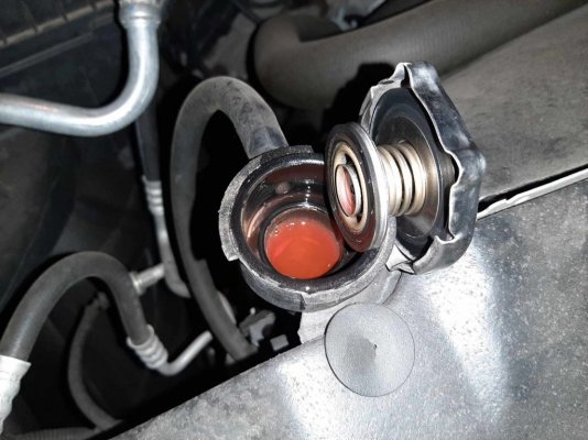

Rome X: I just walked outside to take a pic, and to see what mine looked like.
I have a 2014 Ram, 5.7L V8, about 105,000 miles. Here is the pic, and I'd like to think this is what it should look like, ideally...
EDIT: Truck has not been run since yesterday and it is about 56F outside.
You big show off with your normal coolant system... :)
Appreciate the reference, I'm looking forward to checking mine in the morning when its cool and seeing how clean it looks right after their "triple flush"
