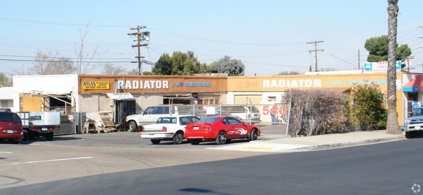

I always use a Radiator Shop
If a dealership knows that there is a issue, they pull the radiator out & they send it to a radiator shop.
Same with a Auto Parts place, they have someone pull the radiator & they send the radiator out to a radiator shop.
Bypass the middleman, go directly to a radiator shop that has been around for years & work on Hot Rods & Classic vehicles, as well as new vehicles.
They can also get you discounts on radiators & associated parts
shops that i have used, nothing fancy, just good work
