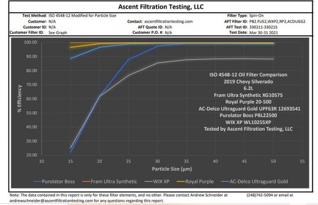

the last 20-30 pages shows you might want to rethink that wix xp. yes it likely wont clog or stiffen up like paper filters do, but it also isnt very good at filtering. We just post the facts, your choice, gl. At 50 microns literally every filter traps that size 99% except wix xp.

Even worse as you see smaller size particles, it doesnt filter at all, as in near zero % effective when every other filter captures most small particles.
Burla
How does the factory Mopar filter do in these tests? Thanks.

last week we finally figured out mopar filters both srt and regular are rebranded wix, so bottom of the barrel in filtering. See oil filter thread for more info/
Thanks, but that sucks. Aren't NAPA GOLD just rebranded WIX TOO. Going to have to get some filters to take to the dealer.

1. Wix XP - efficiency not great but flows like cray
2. Fram Ultra - great efficiency; oil pressure funky if you try to run it past 5K
3. Purolator BOSS - found out that 8,700 miles is the limit before you run into oil pressure issues (lost 5-10 PSI).
4. Mobil 1 - no issues whatsoever. I think this will be my go-to filter from now on!
Is there a chart like this for the synthetic oil filters by K and N and the Mobil 1

I imagine there is somewhere, but I have not seen it. Of course k&n is paper and m1 is combo paper and spun glass. Both finished top 5 in gm test. However, fram ultra and royal purple finished above them, which is only one reason they are popular here. Even though k&n finished top 5 in filtering, that test was with a fresh filter, spun glass retains it's rating throughout the interval, paper goes stiff and goes to bypass, literally a rock or pebble could go through. They only tested 3 100% spun glass filters, and they finished 1,2,3, as in nothing gets through, and they only tested one combo which was the m1 and it finished 4th. So I really don't understand the argument for combo filters, you pay more then paper, but that paper can still go stiff with oil heat cycles. Mise well just buy spun glass? I think guys running combo or paper should be cutting those open in long intervals and post that in syn thread.
