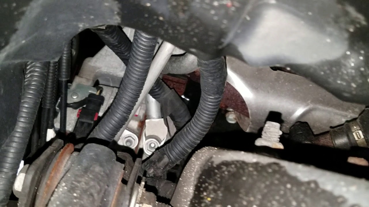

So, the oil change did appear to quiet it down, but it is still present. It is loudest at first startup of the day after sitting all night (so, I would assume an exhaust manifold bolt has cracked again but I have been under there a couple times and the heat shields are very tight and firm). It mostly goes away within a mile of driving and feels very smooth throughout RPM band. I have a 1000-mile trip coming up so, if there is anything serious, it will show up then.

Those symptoms do sound like the manifolds, maybe a crack in the manifold instead of a broken bolt would do what you're describing, tough to say without pulling the shields though.

If it got better and quieted it down quite a bit with the oil change, then it probably isnt bolts, because redline doesn't quiet down exhaust at all. The science of moly, it takes time to plate.
