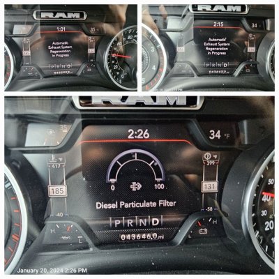

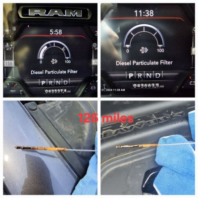

I suspect either it is a injector or the regen mode producing too much fuel into crank case. The truck is still under powertrain warranty I can not touch it at this point or they will void warranty. Dealer has only performed a power balance test on the injectors and thats all they said they needed to do to see if injectors were leaking lol. Everything is documented with the dealership and how they have not taken what I said seriously. Once i bring it back to them with fuel in the oil it will be I told you so. Clanking sound is still there, not near as loud but still there. Batteries being replaced didn't do ****.
I picked my truck up yesterday with them attempting to fix my regen problem. They said I was good to go, drove off the lot and what do you know regen. I went for a drive today and within 43 miles another regen. They did a stationary regen, replace mass air sensor, partical sensor recall, and reflashed the Pcm.
At this point I am tracking regen times and miles and waiting for oil level to rise.
Video of clanking a little quieter.
Regen after leaving the dealer.
Regen 43 miles after that one next day.

I do have fleet guard on the way. I just need to show fuel level In oil is far from normal. I am sure any of these test should at least show that part. I don't need a complete break down.

Yep having miles in the picture helps. Started adding the water marks to the photos as well. It will definitely show how frequent they really are. I guess when the dealer doesn't believe you, blow it up? Must be Rams new policy lol

Short trips are not good on the new diesel trucks. The new emissions stuff just plugs up. When it goes into regen mode it brings idle up, injects more fuel and gets the exhaust temp up to 900-1200 degs. Its burning off the exhaust build up.

Test is coming monday/Tuesday I will ship off right away. This is in the dealerships court and ram. I'll keep people posted, got a post on Hdrams, Facebook and here.

Oh I can daily it for work and can hit over 200miles a day. I work construction and travel a fair bit. No I won't settle for a rebuild at this point It will never end. I don't know the path forward just filling up the oil with fuel like the dealership instructed me to.

It's the top end somewhere. Didn't start till the dealer did all their "service" to it. As much fuel that is dumping into the oil i am leaning to the injectors.
