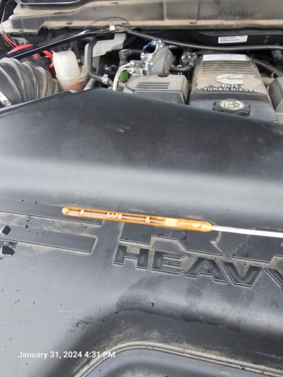

Well it is at the dealership again. There was no arguing this time, and did not sign their typical services agreement. Just verified oil level and took my oil sample to send off.
Picture is not that good but it is over the dipstick onto the cable.....View attachment 536146

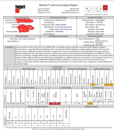

About how many miles are/were on the oil? Noticed your 100c Viscosity was down to 10.8 ( iirc ****** its 14.6) just a bit higher then mine was at 10.2 but then I had 4743 miles on mine, but after seeing your UOA with >10% fuel in oil I think I best be looking at my oil level its been about 1K since the oil was changed...

400miles. It's >10% dilution. So probably 26% fuel in there per dip stick reading.

I stopped by today and had a short talk with Krysta, before i go back next month I want to do a 400+ mile drive, then will let them know what day I will be by to park it for a few hours so all the oil has time to drain to the pan, I'll leave it locked on the lot so no one can easily fool with it :oops:, then come back so we all can check oil level and they can witness me pulling the oil sample, I hope its less than 2% (I can dream right) so far no one is willing to say what's safe or acceptable for the 2019+ 6.7l...

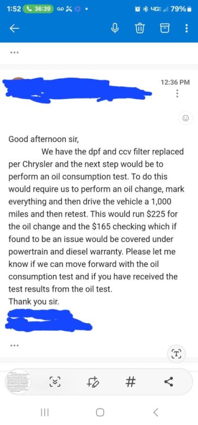

Don't expect much from them is all I can say.....View attachment 536540
OMG what a load of :bs: So they seem to think a new DPF an changing the CCV will fix / stop the fuel from getting in the oil :eek: Heck I'm sure that you know can buy Rotella T-6 5w40 for less than $27 gallon at Walmart, a Fleetguard filter is under $20 and they charge $75 install fee = $176 that is still lower then the $225 they want for an oil change with Rotella T-6 5w40 an a cheap Mopar oil filter.. So what's the extra $165 fee for :hump: BTW are you using B-20 or our standard crappy B-5 diesel?

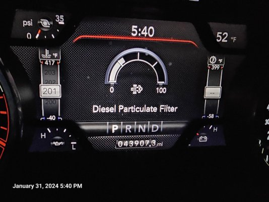

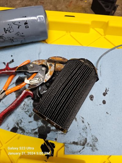

Picked the truck up from the dealer on a fresh new oil change. They had a change of heart at the last min to not charge me anything. I will run the truck and document as I have and run it the next 500miles, return it on Monday. Pulled the dip stick before I left the lot and it was already over full... service advisor was standing there took notes and photo. I went home and cut the oil filter open, not shinny stuff but reeked of fuel. Wife sent me out for dinner so I drove the long way and put on 17miles on my truck filter is showing just over 1/4. This should be interesting run I'll keep everyone posted.20240131_163129.jpgIMG_20240131_170745 (1).jpg20240131_174006.jpg
Yeah its bull but they ended up not charging me. I know the cost of a oil change. My guy normally charges me $165 using mopar filter. I use a shell fleet card normally its B-20.
