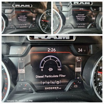

Update!
Dealer has responded to my email with my new photos and documentation on my regen mode. My oil has also gone up since the original scheduled service date. I am on regen #3 in 200 miles, my truck stinks really bad since the reflash.
I am scheduled this Wed to drop my truck off again.
