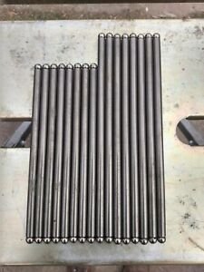

11 grand put that right back to the place that "fixed" it, the mis installed something internal my guess. Rods are known install issue. Pushrods not connecting rods.
Burla
Apr 28, 2012
27,545
57,761
2010 Hemi Reg Cab 4x4
This is why, put a small rod into a large rod hole, there ya go. Bent pushrods on hemi rebuilds has to be the number one cause of misfires that I have heard on this board, could be something else, but could be this for sure. If it is a pushron on number 3, you can be causing damage the more you drive it.

Here... Common bent pushrod symptoms and causes, it also jives with the low mileage.
7. A Bad Installation​
One of the most prevalent reasons for bent pushrods is improper installation. One way is by not tightening the rocker’s arms down enough. The pushrods may be subjected to excessive force and flex if the rocker’s arms are not correctly torqued down.
