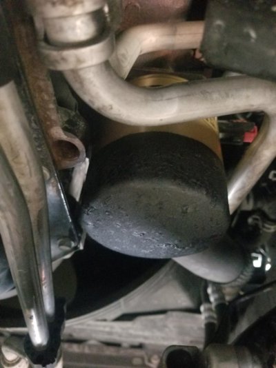

I sure can't - but it seems I have a unicorn Heavy Duty variant made on a Friday with unique coolant hose routing:
Thats a Fram Ultra XG 10575 in there - just about touching the molded lower radiator hose. I've since switched to Royal Purple 20-500, same OEM diameter but longer than the Fram.
It may just be the picture but it almost looks like you could loosen the clamp on the coolant hose and angle it away from the filter? Maybe that's why your truck is "unique" and can't fit the larger filters?
Yeah, I didn't want to loosen the whole system after I'd just changed it to try a bigger oil filter. It sure could be different assemblers moving things around differently.
On our assembly lines at work, we only specified on drawing notes and work instructions a specific orientation if it were necessary for fit and function.
In this case, note they installed an anti-chafing sleeve so's they didn't have to worry about Bert or Ernie reefing on the assembly.
