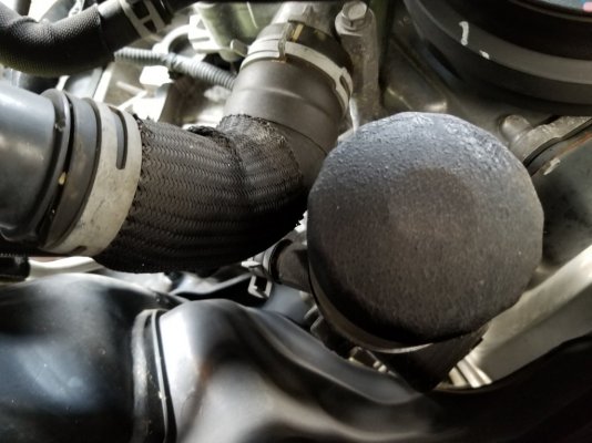

But just for grins a giggles, I found a XG2 and dang, that thing dwarfs the 10060…lol. How do y’all fit them big filters in there?
I sure can't - but it seems I have a unicorn Heavy Duty variant made on a Friday with unique coolant hose routing:
Thats a Fram Ultra XG 10575 in there - just about touching the molded lower radiator hose. I've since switched to Royal Purple 20-500, same OEM diameter but longer than the Fram.

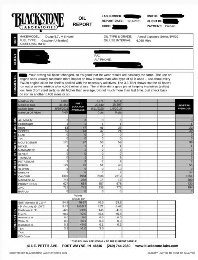

I really didn’t mind running the Amsoil signature series and I was pretty much impressed overall when I used it but being that I don’t drive my truck that much, I just really didn’t think it was worth paying what they charged for it being that I only average anywhere from 5500 to 6500 miles a year. I figured there was just as good of products out there that would yield roughly the same results for a lot less money. Hopefully the schaffers 9000 extreme I’m using right now could be one of those products, maybe even hopefully the mobile one extended performance. I’ll just have to wait and see what the oil analysis report shows when I get that back and then of course I’ll have to wait until next October to see just how good the extended performance mobile one is.
Attached is the Blackstone report for the Amsoil signature Series 5W20 that I ran last year with that same brand oil filter that Amsoil supposedly said for us to quit using.
