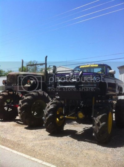

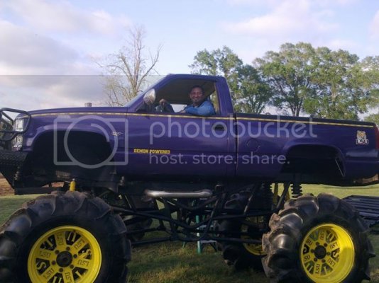

yes your right, i left my plugged up bec we were going mud riding alot with the 4wheelers and the monster mud trucks and it has ALOT of dust out there so I capped it for the dust. well now i can uncap it since i work more and not enough time to play in the mud
here is two pics of the mud trucks .
