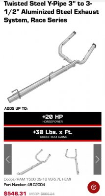

You guys are forgetting the most important part with your shorty header install which is get the y-pipe where a good pickup of power can be made.
For example. I don't know of every manufacturer that produces these im sure the vendors can take it from here. :D

In Ma if you delete the cats or resinators you will fail inspection. But for the states you wont, at that price point why not just go with LTs?

yup and that is not even SS
you can keep the factory cats and piping but have the Y section replaced with a Magnaflow y to get better flow

I did both & the AFE y pipe gained a good bit over that. 1st I had the stock cats with a Magnaflow y in place of the factory crushed y. I picked up a little pep & sound by doing that. Was worth it. But then I replaced that with the aluminized AFE y & wow what a difference. It picked up a noticeable amount of power. I dropped a tenth & half in the 1/4 mile over the 1st set up. The AFE y is well worth it. Anyone wanting to but 1 just missed the normal sale they have though. They come down to $420 every yr for Black Friday.

They have a catted version as well. :D

Simply because this thread was about shorty headers instead of Long Tubes
