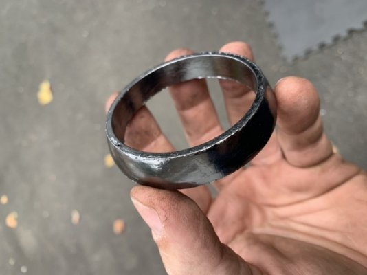

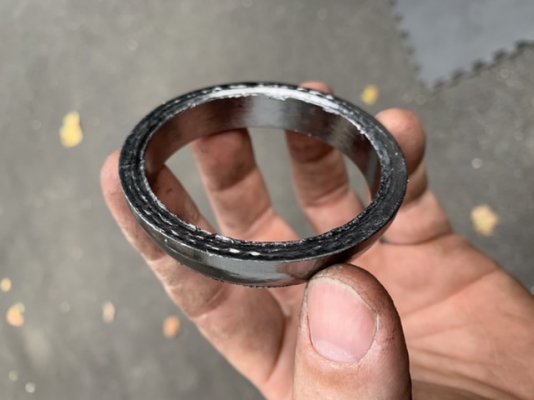

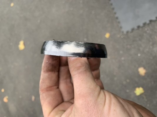

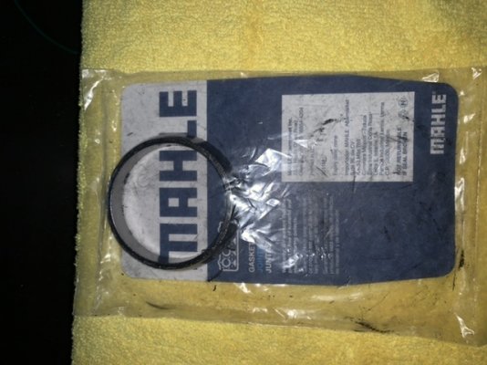

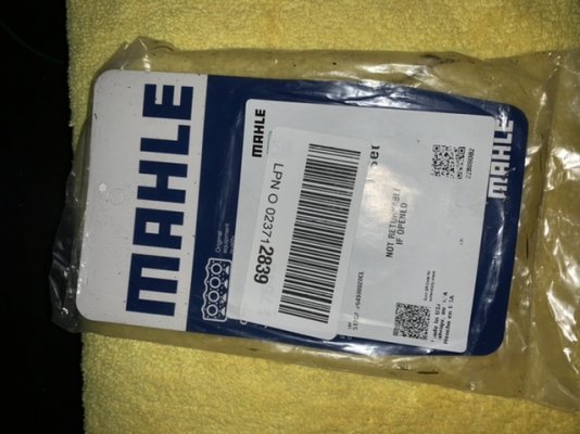

Well it seems like I fixed it! For all the people who check this in the future this was my fix which I did tonight and started it up and pretty dang quiet Minus the valve train. Took alot of searching to find a gasket that fit my specs and the material I wanted.
I removed the bolts and then took a Mahle donut style gaskets which matched the ID of the collector (2.25”) measurement I got from the manufacture. I took a carbide bit and ground out the inside of the gasket edge (not in the pics) to remove the hard edge and installed. The gasket is a graphite style gasket with a steel core I believe. I wanted the graphite bc of how it seals and withstands super high temps. Lined everything up and tightened it all done and boom no leaks…. Now let’s hope it lasts.
Pics of the gasket and part numbers. This will only work on the power go headers as the collector ball is smaller DIA than stock.

Where did you get the gasket? I can't find anything with that part number. I have the same exhaust leak when under load and this is the first post that someone has solved the issue. I already replaced the manifold gaskets but with no luck. I'm going to try and find this gasket and see if it work with my BBK shorties.
Black1500Ram
Jul 18, 2021
621
1,047
Scottsdale, AZ
Anyone looking for the gasket it’s part number is Mahle f7549 as seen under / behind the barcode sticker in picture 1
*edit - gasket is too small for oem sized collectors (AFE)
