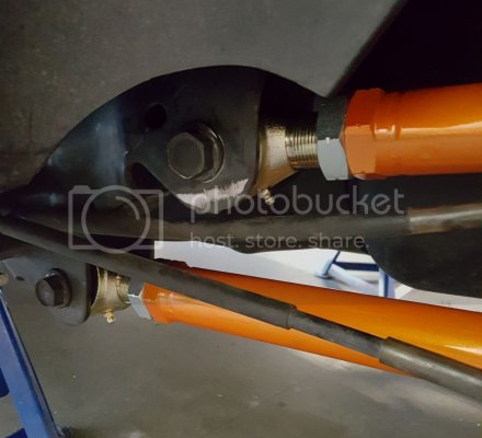

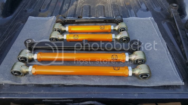

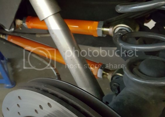

SKWURLZ, any update on your new setup? I'm about at my limit with these Spohn arms.
So Far, they are working amazing. No noise, no clunking, no more sloppy downshifts or 2 to 3 clunks. It's now hooking up so well that my driveshaft went out.
The truck will start to load/squat, then it just hooks and moves. It did take a bit to set the lengths and pinion angle, but once set, everything is awesome so far. It's also more compliant and its more comfy / plush when cruising.
To be completely transparent, I do still get a very slight speed wobble, but it now doesn't appear until 124mph+, and goes away as fast as it shows up if you keep on the pedal or decel. If you stay at exactly 124 to 126mph, the wobble will stay, but barely noticeable, and others that have been in the truck with me all tell me I am nitpicking.
I now think the wobble is completely related to driveshaft and pinion angle, and not the arms position. After all these parts and adjustments etc, I am confident more adjustments will eliminate it completely. Possibly an aftermarket driveshaft will solve it.
I also did run into clearance issues with my MBRP Exhaust hitting the axle on dips, as I centered the axle by moving it rearward in the wheel well by 0.5"
I solved this by pulling the rear pipes from the muffler, and running two turn downs. Its way too loud now. Lol
Currently my axle pinion is at 4.1° up, and my trans tail shaft is at 5.1° down. Approx 1° pinion difference, which is what I found reading through countless Drag Suspension Set up threads. Maybe more adjustment to a neutral angle is needed.
Pics for views:
Nice man! That sounds freaking awesome and you got the pinion dialed in perfect. Glad to hear it has gone so well. Get yourself some ear plugs. [emoji1303]

glad it is all working out the way you wanted it to. Any possibility of sharing the source of the parts you used and part numbers?
I made them. They were spendy though. I can make more, they would run $1300 a set of 4, shipped. Any color powdercoat.
Pics for views:
Very nice man! Looks professional. If I ever get tired of these Spohn arms I'll be heading your way! Good to hear there's no clunking......as I thought there "might" be some with the Johnny Joint. Let us know how she's doing after you beat on her some more:buffer:

I'll be interested to see how it goes man! You should start a thread up on the build so we can all follow along.
2" Female Chromoly 1" Forged threaded rod ends were $32 each, and the joints were $56 each from Currie Enterprises when I bought them.
