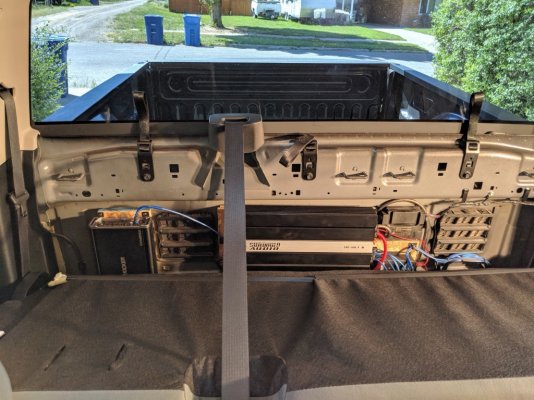

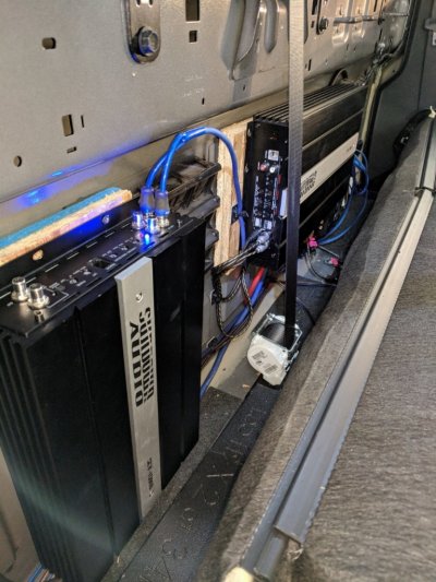

Next I mounted the LC7i to the back cab wall. I cut some plywood to size and glued it to the cab wall with Loctite PL Premium FAST GRAB Polyurethane Construction Adhesive (that stuff works great!).

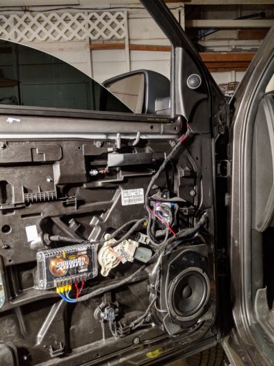

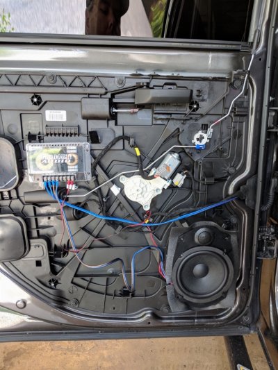

Then it was time to run the wires for the door speakers. For the fronts, I removed the wire plate that mounts to the door, then disconnected the plugin module and unhooked the two plugged in modules. Then I fished the wire through that rubber hose line and then through a small open space on one of the cab side plugs, the passenger side was way easier as it only has one plug plugged in.

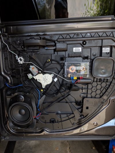

Here is one of the the rears, pretty much the same as the fronts but much easier to get at. The plug in the B pillar has a lower corner space in the plug that the wire fits perfectly through.
This is all the doors finished.

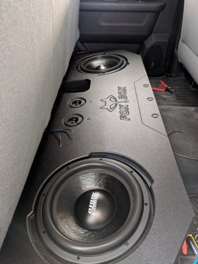

- Foxbox with Dual 12" Vented
- Kicker 43CWR122 12" subwoofers with dual 2-ohm voice coils
