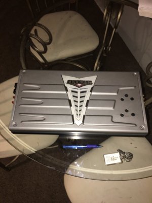

What does that mean? My LC7i wont be able to power the subs?
It starts cutting frequency at 32hz. its not a hard wall, but it will sharply decrease volume of subharmonic frequency below that. Most amps do some version of this as well. Kicker I think does 25, some may go down to 10... kenwood used to.
The thought process is not to waste power in a frequency that you cant hear or most subs fail to reproduce.
Some audio control products used to allow you to change out the chips for lower cut offs, im unsure of the specifics of current products though.
