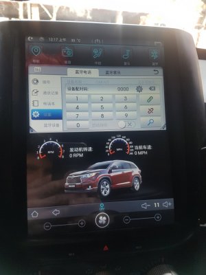

please can someone tell me what I did wrong except be a total dump truck
ok so bluetooth issues I thought was the unit not picking up the pair so I somehow ended up downloading a launcher which then I got into system settings and I totally ****** the whole thing up everything is flipped if i want to click top right corner i have to click bottom left and it's all in Chinese and please is there a way to reboot it15727978307144847961338736265764.jpg 15727978307144847961338736265764.jpg
ok so bluetooth issues I thought was the unit not picking up the pair so I somehow ended up downloading a launcher which then I got into system settings and I totally ****** the whole thing up everything is flipped if i want to click top right corner i have to click bottom left and it's all in Chinese and please is there a way to reboot itView attachment 185157 View attachment 185157

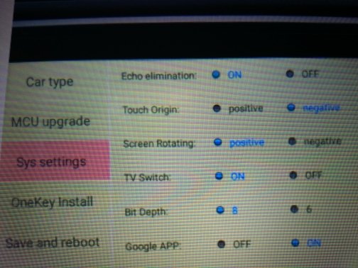

You will need to change these settings "touch origin" and/or "screen rotating"
Start with touch origin. Unfortunately, you'll have to do it by guessing where to press. You can force format the radio to default everything but this erases everything on the radio.
