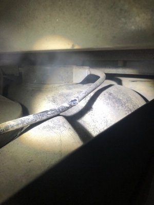

I picked up a new client back in July so I brought my truck to them today and they found the leak above my tank that no one else could. Apparently I have a squirrel problem home or office. I think that’ll leak. upload_2020-11-12_13-57-29.jpeg upload_2020-11-12_13-57-29.jpeg

Evap leaks can sometimes be tricky to track down. It looks a smoke test found that one pretty easy though. Lol. Damn rodents...

That was the third smoke test. LOL Not to mention the cheap cigars I burned trying to find it. As you can tell by the pic it’s not a brand new hole either.
I’ve driven around so long with the CIL on it scares me to look down there and not see that yellow light down there.

That was the third time at least a smoke machine had been used. The first time was a Dodge dealership. Once was a very reputable shop, according to what I was told.
