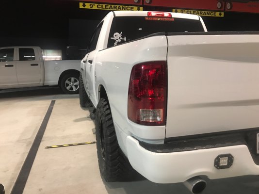

Dropping her off at the dealer now. She's still under power train warranty. Find out in a couple of days what the problem is, although I'm positive it's the manifold bolts.3e749adc4888ade94487a28ebba26cec.jpg

Got the truck back today! All under warranty. Ended up being a warped left manifold and broken studs
