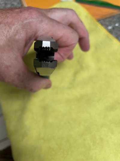

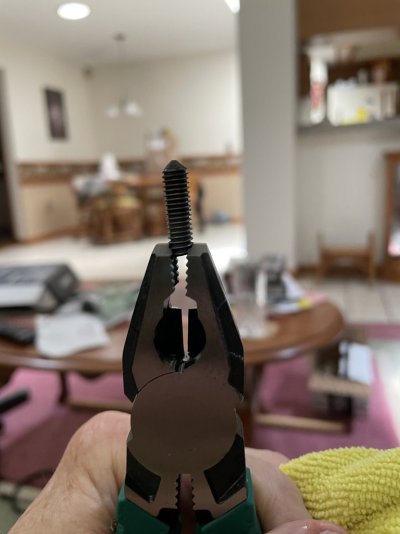

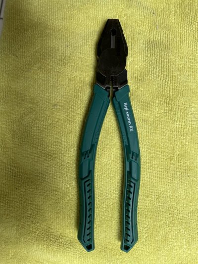

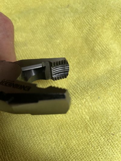

I have a friend who is also a DIY mechanic. Over the years he has recommended some really good tools to me. One of these pliers is made by a Japanese company called “engineer”. The pliers are called “ Neji-saurus”.
They are specifically designed to remove stripped screws of various types. I drained the pan a little while ago and removed all of the other bolts. By the way I was able to get the pan out this time without loosening the mounting bolts!
There was about 3/16” of bolt sticking out. With these pliers all you need to get is just a little bite on it and out it comes!
I don’t know if any of you guys have these pliers but they are absolutely amazing’83EA9200-098A-4B1A-96F2-25D49B4C525A.jpeg

@HangmanNY , glad you got the stub out. I know that is a relief.
Sounds like you are doing great with the drain and fills. I think you will be good to go with the new bolts.
Those pliers look cool. Pretty much like linesman pilers, with a twist on the jaw design. Neat

I have been buying a lot of tools bit by bit for the past few years, including a lot of Knipex pliers. Those Japanese pliers have a specific purpose and they are worth their weight in gold when that situation arises.
The company is called “Engineer” . Those pliers are called “Neji-saurus RX” (model PZ59).
You can find videos of them online. There are no other pliers like them. All they need is to just have a little bit of bite on any stripped screw or bolt. And they will extract them!
