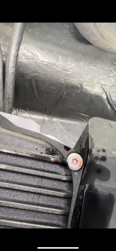

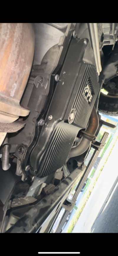

Hey guys, I’m in the middle of doing the procedure as we speak now. I can not seem to fit the OEM pan spacers into the PPE one. Is it okay to go without the spacers?
FORGEDRAM
Jun 28, 2022
22
21
Orlando
V6

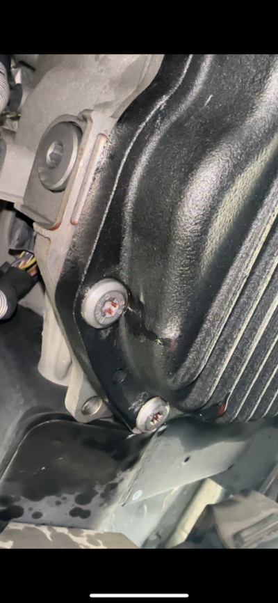

Alright guys, got the PPE pan installed. Pan bolts torqued down to 9-FtLbs / 108-InLbs. I did not use the OEM pan spacers. Made sure fluid level was good using the correct check procedure between 86-122 degrees. Took her out for a drive to get the transmission temp over 160. This temperature is when the transmission bypass valve opens up/closes I guess and it really cycles all the fluid through. My plan was to do this then let the truck cool down then recheck the fluid level once again.
Unfortunately after my drive I have found a leak under 3 of the pan bolts.
Was wondering if you guys had any advice for me . Kind of stumped.
Going to let the truck fully cool down and re torque those 3 bolts to spec just to triple make sure.
