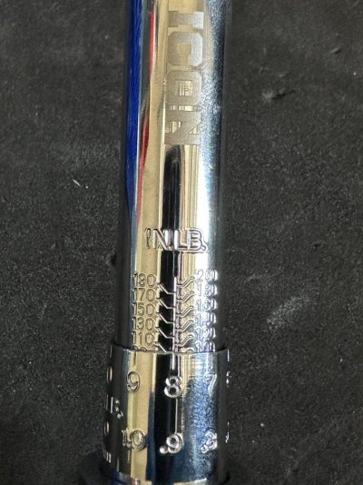

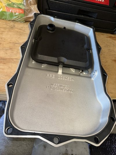

Alright guys, got the PPE pan installed. Pan bolts torqued down to 9-FtLbs / 108-InLbs. I did not use the OEM pan spacers. Made sure fluid level was good using the correct check procedure between 86-122 degrees. Took her out for a drive to get the transmission temp over 160. This temperature is when the transmission bypass valve opens up/closes I guess and it really cycles all the fluid through. My plan was to do this then let the truck cool down then recheck the fluid level once again.
Unfortunately after my drive I have found a leak under 3 of the pan bolts.
Was wondering if you guys had any advice for me . Kind of stumped.
Going to let the truck fully cool down and re torque those 3 bolts to spec just to triple make sure.

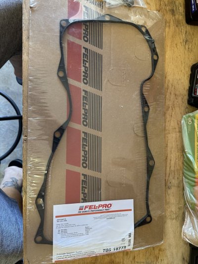

Hey brother, I used this Felpro gasket that was recommended by another member in this forum that successfully installed a PPE pan on his V6 Ram. It was a perfect fit !

I let the truck cool down to about 92 Degrees. Jacked the rear up so the transmission was level, and re did the fluid level check procedure. Started the truck and cycled through the gears, and when I went under to pull the fill plug, no fluid was coming out! I think I had to fill about another half quart till it started to overflow out. Finished just in time @ 118 degrees.
(Side Note: When it came to the steps where you have to run the truck in second gear for 5 seconds, well she really did not like that. I got a bunch of codes that I had to clear at the end of all this. I will attach a picture of the codes)
After this, I went to recheck the torque on the bolts that were leaking. They were loose! I checked all of the other bolts and im shocked to say but over 75% of the bolts were lose, I was able to give them all some more turns until torqued to spec! (108 Inch-Lbs)
I have no clue how this happened. When I originally put the pan on, I 100% made sure ALL BOLTS WERE TORQUED TO 108 IN LBS.
The only thing I can think of is either with the fluid lubricating the bolts possibly and heating them up and cooling down when I went for the drive after?
Or maybe the fact that I gave a generous amount of anti-seize to all the bolts when installing and maybe that contributed as well? Idk, would love to hear your thoughts.
After retorqueing all bolts, went for another drive to get the temps up. They got up to over 180, no more than 184 if I remember correctly. Came home and what do ya know, there is no leak anymore! lol!
In Summary, I drained 5 1/2 Qts with removal of OEM Pan.
I refilled 6 Qts 28 Oz (Almost 7 Qts / 4 Oz Shy) w/ PPE Pan.
PPE Pan = $350
Felpro Transmission Pan Gasket TOS18773 = $30

The 108 in-lbs spec is probably for dry bolts. You basically lubricated them with anti seize so you will have to get them tighter. I had issues with an aftermarket pan gasket leaking. If you cant get it to stop after tightening your bolts again, you might look into an OEM gasket. They were under $20 when I bought mine. Mine also gets angry when you drive the truck in the air. It should all go away on your first drive afterwards.
