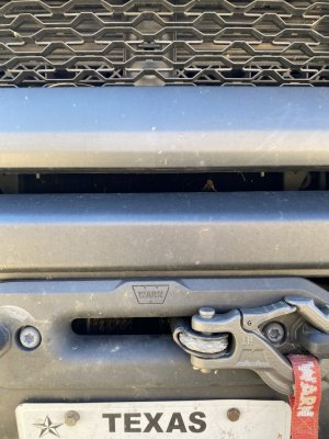

I meant a synthetic rope. https://www.warn.com/spydura-nightline-100ft-synthetic-rope-assembly-with-hook-102558https://www.amazon.com/dp/B07H5CYGBK?tag=duckduckgo-iphone-20&linkCode=osi&th=1&psc=1
change out your cable with a rope and you don’t have to worry about the cable taking off your head. But yes using a blanket or a floor mat is popular to drape over the cable. The kit as a whole may not be needed but check out the contents. You may like a few things in the bag.

well there is a little more. You need a fairlead too instead of rollers.
I haven’t tested the $100 rope out as I never broke the ropes that came with my winches. I use snatch blocks when needed to reduce the load as well.

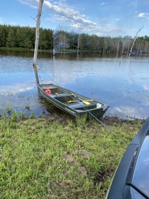

Not much Vehicle recovery lately, but I did have some pond clearing that needed a winch (or long rope) we pulled at the base in hopes it was rotted enough to break off under the water. Success!
The good thing (pro)about a rope for over the water is the weigh is manageable. The bad thing (con) is, you should keep it out of the mud, as the sand embedded in the rope will shorten the life and the strength.

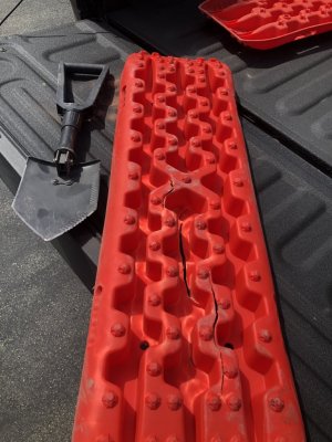

0AF49110-4DCA-4DB9-8D16-D600BCDCC370.jpeg I had a pretty good solo recovery with my 2019 Power Wagon on 4/29 out in the Lytle Creek CA area. I was exploring some pole access roads Lone Pine Canyon Road. As I turned a corner on the trail there was a deep washed out rut on the passenger side of my rig. At the time I couldn't quite see where it started or how deep it was. I cleared it with my front passenger wheel but then felt my rear passenger wheel drop into it, ultimately resting my rear axle pumpkin on the dirt. I couldn’t reverse because there was hard rock behind my read axle so forward was the only option. I locked up my axles and tried to crawl out but because the trail sloped down toward my passenger side my front passenger wheel slipped into the rut. At this point both my passenger wheels were in the rut with nothing under them and steep raised embankment on my passenger side so everything had to be assessed from my driver side. Should be noted there was nothing with in 300 feet for me to winch off of :-/. I busted out my shovel and started digging dirt to fill the rut under my front passenger tire along with gather large rocks to pack in. I had to clear away some packed dirt in-front of my front axle and sway bar as well and did the same for the rear. After about 45 minutes of digging, filling and rock gathering, I had created a “ramp” under my front passenger tire. I placed one of my X-Bull Traction Boards ($65 for two on Amazon) under it just for good measure. With both axles locked I was able to crawl out, fortunately without causing any damage to my rig, at least that I was able to find. I did crack a traction board but I’d say it was worth the cost.
Good reminder to always have some basic recovery gear with you. Also another good reminder to not go out solo, which I did.
As someone without a lot of recovery experience, is there anything I could have done different here beside get my wheels in a 2 foot deep rut?

Love it. Nice job! My advice, get a bigger shovel and another set of traction boards for that price!

I’m no expert by any means but you got out without injury to yourself or damage to your truck so it sounds like the recovery went well. Short of not getting stuck couldn’t ask for a better result.
I’d say the traction board is a sacrifice to the off-road gods lol. Always wondered how the amazon boards would hold up.

For the money and being I’ve had them for several years now on both this rig and my last rig and this is the only time I needed one of the two, I’d say very worth the cost. The Maxx Trax are nice but just sooooo much more expensive and honestly I think they would have cracked under the weight of an 8500 lbs truck while being stacked on rocks.

If you tend to do wide open country off road, then I recommend a land anchor. That way you can always winch. A hi lift jack would have made it easier to put the jack on the hitch to get the pumpkin off the ground to then put your traction pads underneath the rear tires. Or a soft shackle in the rim and lift one rear tire. But you need to have one has part of your recovery tools. Not that what you did was wrong but what sounds like what took you and hour (and maybe a blister) could have be no more then 15 min.
There is a lot of ways to skin that cat.
If all I had was a shovel and skids then I would have dug out a wedge under the back tires so that when I reverse I pull the traction pads in and under creating lift.
Remember you asked. :cheers:

Thank’s for the feed back. I did actually have a hi lift and a soft shackle but both my passenger side tires were floating about 12 inches off the bottom of the rut so i had to pack something solid under them. I also couldnt access my passenger side because a steep embankment basically came up to about mid window height. I will probably buy a land anchor though for sure because that would have actually been the most useful thing to have. Learning from this, if it ever happened again a winch point on my driver side would have kept me from sliding my front passenger wheel into the rut.

Would have loved to see pictures of the setup and the recovery. Next time!
