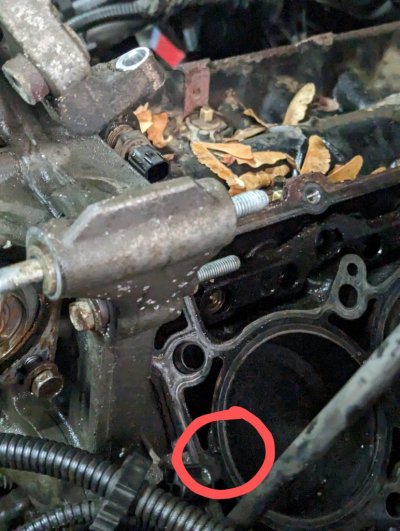

I found this weird clip resting between the cylinder head and block on the passenger side when doing the head gaskets. I don't recognize it but wondering if anyone else does. If anyone is curious yes someone was in it before at some point because I found a few broken studs on the exhaust manifold. Wondering if this was the cause of the head gasket leak..... Roughly 1" x 1"?

I now found another one on the other side exact same spot under the cylinder head. Have to do some investigating......

Well I can't find them in any service manuals and it almost looks like a lock clip for a coolant line or maybe an intercooler? The heads are out being resurfaced so they will be gone for a week or 2 so I will keep looking in that time and hopefully someone posts what these might be. Her is a photo of where they were laying. One on each side just laying on top of the block.

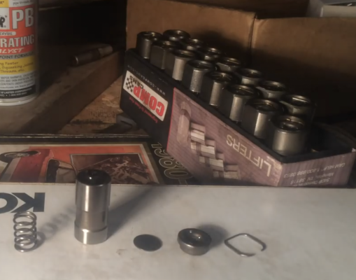

So I wanted to update this post and let everyone know my results. The clip is from the lifters. On the end of the lifters a clip is used to lock it all together. Looks like I will be replacing the lifters and hopefully the camshaft is in good shape but will find out. Here is a pic I got from a YouTube video which shows the breakdown of parts In a lifter. Screenshot_20230102-204943~2.png

Just throwing this out, but if you're this deep into it, I'd recommend not reusing the original cam and popping in a new one, and maybe new rods too.
Yes an expense, but you're going all new and fresh, so make it a full tight job and leave no chance for old product to hamper a new scope of work.

Were the heads resurfaced ? If so you should get a fresh measurement for your pushrods , as the length needed will change.

Heads are getting resurfaced and I will get them rechecked. My guy mentioned the same thing.

Here is an update. I pulled all the lifters without absolutely no issues. None stuck amazingly. Lifters are actually in nice shape except the fact that quite a few of those lock clips have fallen out of the lifter. All the lifters came out whole with no missing pieces. I took my camera and looked into the holes at the lobes on the camshaft and they look good as well. I think I got lucky that more damage didn't occur. I took pictures of the lifters if you want to see or see anything I didn't.
