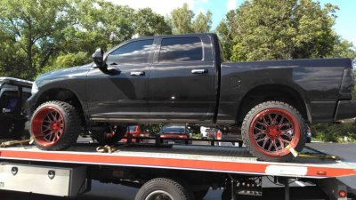

Sorry guys no pics they had it on the roll back when I got back to it since my dad hooked me up with some triple a action basically saved the inspection fee at the dealer lol. Hopefully I can get some pics of some wrecked parts when they tear into Monday. KIMG0024.jpg

I did notice some grease mixed into those pcs though. Pretty sure it trashed the wheel bearing also.

I didnt think about that. The grease I found was cooked so it was for sure hot af
