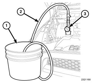

They shouldn't be driving it to burp it. They should be using a Mopar coolant system refill tool such as:
  1. Refer to the Mopar Essential Tools and Service Equipment Tool, UView Airlift(TM) Cooling System Refill 399-550000 or equivalent and follow tool's operating manual for specific assembly steps.
Basically, they should drain and flush and drain the entire system again, then use the tool above to induce a vacuum state on the system while empty. Then put coolant into the bucket and open the valve on the tool. The system's vacuum will suck the coolant from the bucket. When the system pressure reaches zero, it will be refilled with no air.
    • Refer to the Mopar Essential Tools and Service Equipment Tool, UView Airlift(TM) Cooling System Refill 399-550000 or equivalent and follow tool's operating manual for specific assembly steps.
Iv been looking for somthng like this to show them. Thank you very much sir.
