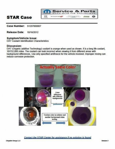

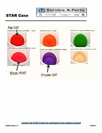

I asked this question to a local Mopar group on Facebook and got a reply from a tech that works at a dealership.
I asked why my coolant was pink/orange when it's supposed to be the purple OAT and his response was:
"The color varies between which supplier they bought it from, The Fiat 10 year was red, Mopar varies between purple and a cranberry pink/orange color. I can't say that I've seen that much of a change in the 10 year purple at 5 years, but it is possible."
He also posted some pics of Star cases about the color which are kind of hard to read but here they are.
I also asked him outright if he thinks it's HOAT and his response was:
"No sir. But, if you don't feel comfortable leaving it in there, you could at least drain and fill the system with the correct OAT coolant."698e4c3d6e02f0cdae570be3ea30e063.jpg60358853b63f0f5a917862bbf3d4655e.jpg
That’s a horrible response from someone who is supposed to be a tech. A simple drain and refill would not do the job. You would need to completely flush your system to rid it of any traces of HOAT before replacing it with OAT. And by no means should the factory be sending out the Fiat version of OAT in a Dodge vehicle. The whole purpose behind having different colors was to avoid confusion, not create more of it.
