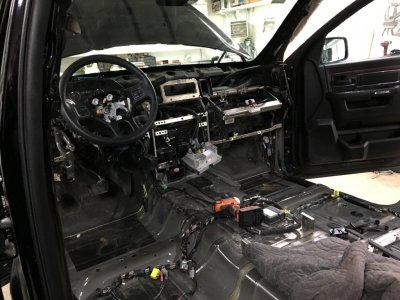

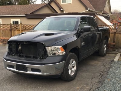

The picture of my truck with fenders hood bumper but no grill is what it looks like now. I have a few others like the cab and box off when we were replacing the front frame. When the interior was completely gutted and we had just put the dash frame back in. Because the guys who cut the fenders etc off the front started a fire inside and didn’t see it right away. It burnt the BCM and body harness. My 2015 tradesman now how as 2014 BCM and body harness from a well appointed 2014 Sport edition

Unfortunately the truck and I are 3000 miles apart. So I didn’t have many pics from when it got delivered from the insurance auction as I wasn’t there. My Dad who is a mechanic and about to retire has been doing most of the work. I’m handling the electrical and software side and diags on things he’s never tried before. I just spent a week out there. Married the 2014 Sport premium Body harness to the tradesman tail harness. 39 vs 31 wires and a day of splicing. But everything is working and running and I’ll finish the interior electrical when I go back in July with my kids and we drive it 3000 miles home.
Every single part has come from wreckers that he does work for so he gets parts very cheap and sometimes free.

I only have a distance photo of the truck before much was done to it. You can see the fenders and front end were missing and the hood is there but bent. The box was fine but we removed it so we could fix the frame.Box off.jpg

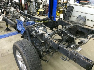

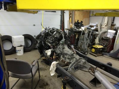

And in case your wondering, here is what a RAM looks like with the Box off, and the Cab is floating in the air above the frame. Here it is torn down to the point where the engine is about to come off and the front section of frame (which is bent) is about to be cut off.IMG_0353.jpg IMG_0355.jpg

Thank you for the pictures of your project truck ! :) I love seeing these kind of things ! :) Amazing the talent out there from people like you ! Looking forward to updates
