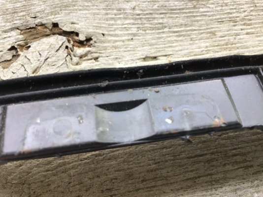

here are pic's of the R side, the L is pretty much the same. Any ideas on this?
TIA :happy160:

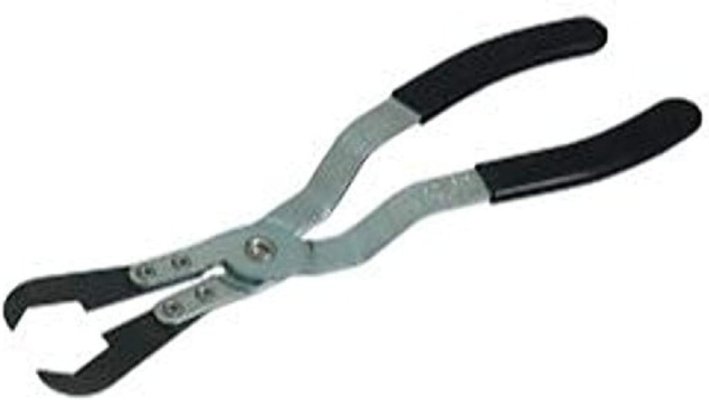

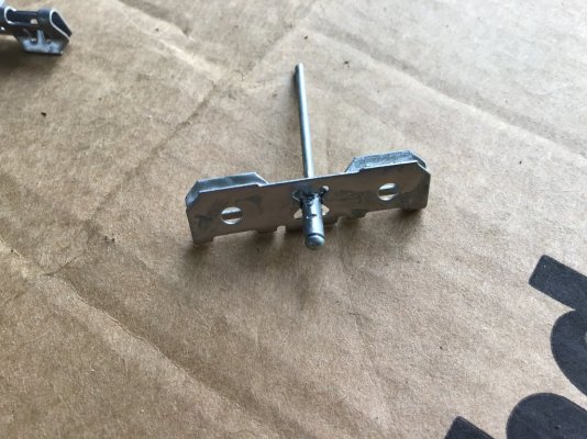

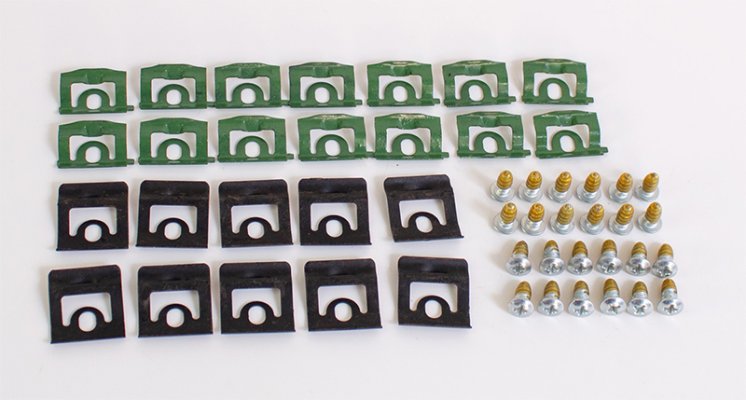

The retaining clips are very similar to what has been used since the 50/ 60's to retain windshield trim although these are double sided. I'll attach some pic's of the clips and 2 versions of the tools used to remove them. I'm thinking they'll work on these as well.
thank you again :favorites13:

These clips are available from Geno’s garage , about $5.50 each . Four on each side . You can see the witness marks on the moulding , line up the circles. These do not appear to move once the moulding is fastened.
The hole for the rivet is about flush with the windshield, so it looks pretty tight to squeeze a rivet gun , to get er done.
So after thinking for a few days , I located rivet guns at harbor freight,for $ 4.99.
I bought two ,with the plan to put the belt sander to the tip where rivet inserts.
I looks like this will allow it to get the angle better , so it sits flush.
I will post pics and other information as soon as I have all the pieces.
I painted the new clips to help with future rust issues.
