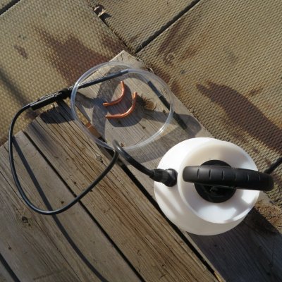

If you don't have a transfer pump,it's easy to build one out of a cheap 1 gallon garden sprayer.Having one will make the job easier.
