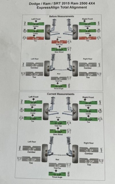

Attached is the alignment reading before and after and my two front tires after removal, notice right's wear and shoulder round. I am at a loss here and worried that I may find out there is something tweaked down the road that my insurance should pay for if I do not solve this right now. Any help is appreciated.
Note, Is the right rear Toe too much(.23) compared to the left(-.03)?
