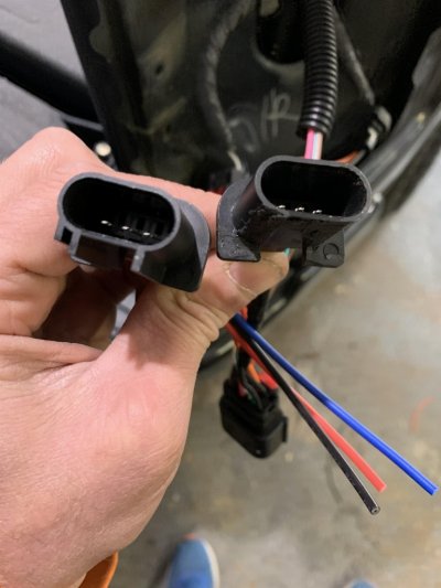

Recap on AlfaOBD settings and connector notes:
This is how I modified the H13 connector for the factory incandescent 3-way connector- sYZh9i9.jpg
If you have factory incandescent tails, I suggest running the light fault sense wires up to the BCM just in case. Mine is a 2017 and I don’t need them enabled, but I don’t know how other years will react with the LEDs and bulb out detection. So, might as well just run them since you have to run two other wires to the BCM anyway.
I grabbed the run relay control from the backup camera tailgate/chassis connector, which is in plain view, and easy to get at between the bumper and spare tire.
Wires to connectors and pin numbers (incandescent factory tails)- MB5XKu4.jpg

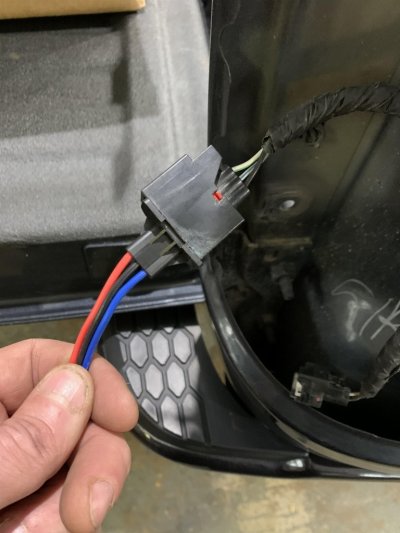

Pin 3 on the white door module connector (C1) is the blind spot LED signal. Pin 2 on the same connector is the blind spot LED return, which is shared with the puddle lamp return.

Did you need a resistor for the LED or did you just connect it directly to the door module?
Sent from my SM-G965U using Tapatalk
Jimmy07
Feb 23, 2017
3,512
3,565
No resistor. I highly doubt the door module circuits are PWM’d.
