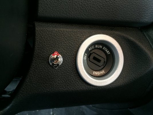

I just installed the 3XL (three times lock) remote start sold by "doug43235" on eBay that so many of you have mentioned. It went fairly smoothly. I would not call it easy, but certainly not hard. There were a few moments where I kind of had to figure it out as I went.
My kit included the Directechs 4x10/5x10 module, XKLODAER 2 programming tool, and Directed THCHC3 T-harness. Programming was fairly easy with the instructions that doug includes. Temporary login info for the directechs website was included.
Here's where I mounted the Remote Start Safety Override Switch:
Overall, I'm pretty happy with how things turned out. It works great!

I just zip tied that switch up under the dash but am curious what the purpose of it is. It disables the start function i think, but why?
I think for safety purposes. The factory remote start has a good latch safety to prevent the engine from remote starting while open.
