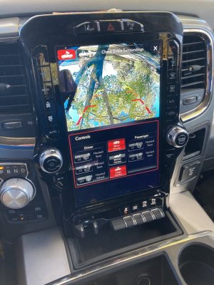

Question though.... instead of having the full surround camera setup working, can it be set up to just have the Front, rear and cargo cams and thats all?

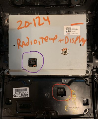

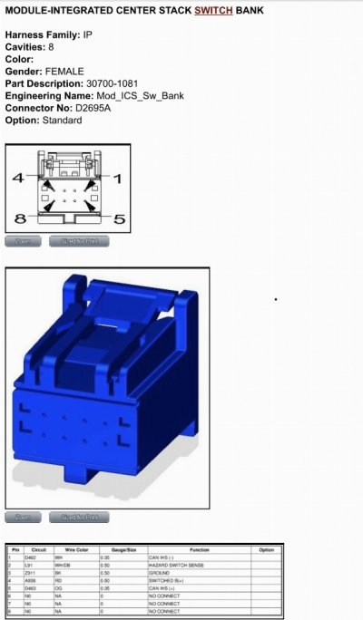

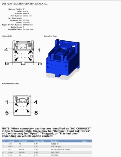

A conversion Y harness needs to be built for the HVAC/Hazard switch controls. The two circled connectors are the same 8 way connector that contain the same circuits, just with different pin locations, and they both need to be plugged in. yuEl6tW.jpg The red circled connector is the original one that the factory dash harness plugs into. Here’s it’s pin layout- z5gnK5e.jpg
Here’s the pin layout of the purple circled connector on the display screen- dzz3c8o.jpg

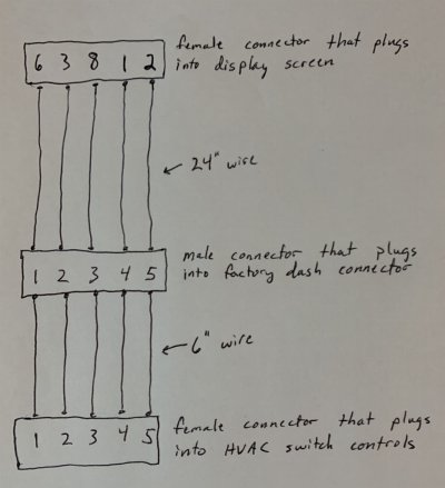

You’ll have to build a harness that plugs into the female 8 way dash harness connector, takes those circuits, and branches them off to the appropriate pin locations on both circled connectors. HqoOBlH.jpg

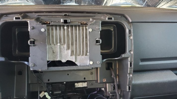

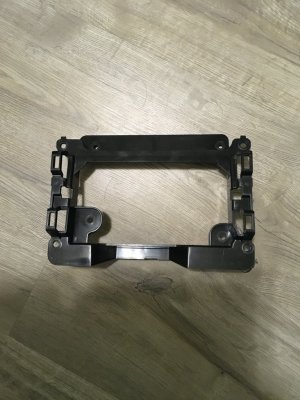

Did a similar install but even with cutting the brace, the module doesn't have a place to bolt in. I ended up custom making some brackets from 1/8" aluminum and plan to have a buddy cut a nicer version with his CNC machine. 028a7356a596764f6c66fd082b91879f.jpg
Sent from my SM-G975U using Tapatalk
mine came with a bracket that would allow you to mount it to the old radio mount.

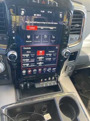

Everything works flawlessly with the UAV. I'm currently working on doing the 12" now and the only issue I've found so far is the buttons on either side of the screen don't work properly. They bring up the corresponding feature on the screen but you can't adjust anything with them. Hoping to work with some of the guys on here to figure out a solution.
Working on it and making some good progress. @skuppy069 is doing some testing with it but it needs a bit more refinement.
