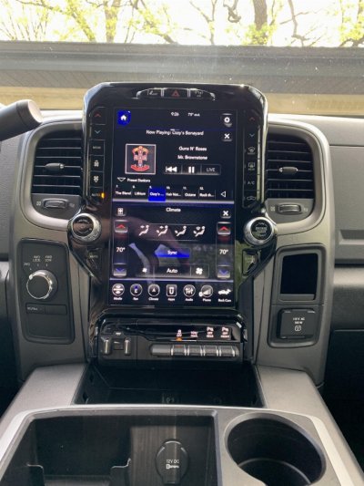

Once jimmy got the uav to work it made me try this and Roman was able to show it could fit it was time to try
My first attempt I messed up a bezel and had too get another
I think if I did this again I would have my screen up a bit higher
Less cutting of other materials in truck
I did end up cutting it in a bit higher.

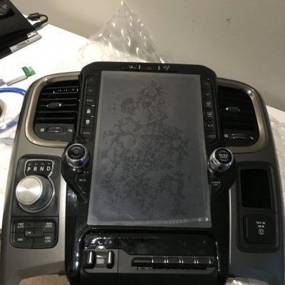

It’s real and in my 2017. There’s three of us doing this right now. It requires extensive cutting of the center stack with plastic and bondo fabrication, along with trimming of the vent mounting tabs and shifter/ac outlet mounts. Need a conversion harness and some changes in the BCM.
There’s a few issues and few unknowns- the physical HVAC buttons on each side of the screen don’t work, but all HVAC controls work from the screen. The traction control on the lower switch bank stays lit, but using the button operates TC normally. Hill decent control can’t be retained because there’s no switch bank button for it on the 2019+ HDs, as it moved to the transfer case selector switch location. The aux buttons switch bank option may not work, but I’ll be testing that out. This probably won’t work on pre-2016 rams without using a 2016+ BCM.
As far as the radio itself, everything works the way it’s supposed to so far.

@Mpgrimm2 I am working on getting a conversion module to get the HVAC controls working from the screen with @chrisbh17 helping out quite a bit. I have a lot of the code figured out at this point and @skuppy069 has an initial version of it. The buttons work now but there are few things still left to finalize.
The issue is that the ICS has different message IDs/messages than the screen bezel buttons. I set up a module to do the conversion of the messages. The HVAC controls still work from the "Climate" section on the screen though.
The biggest part of this mod is the extensive cutting of the center stack panel.
The rearview camera works with the 12inch screen as well. We are actually having a lot of trouble getting the radio to use the digital coax camera input.
