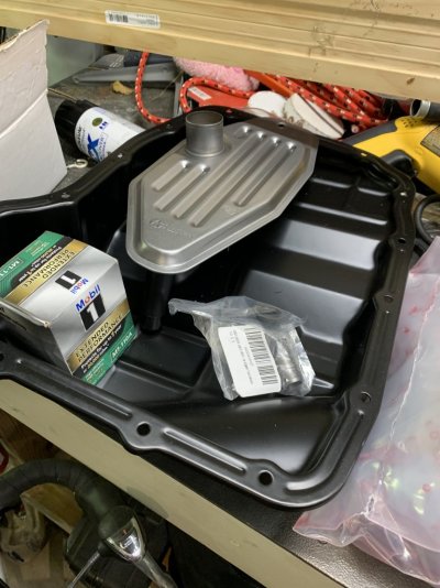

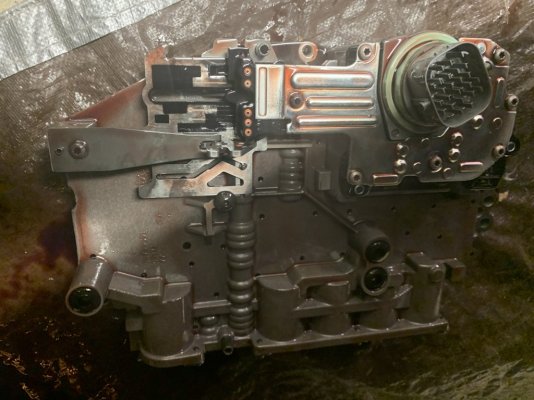

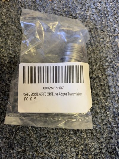

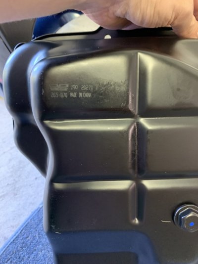

Some pics of the parts and when I had it apart:
