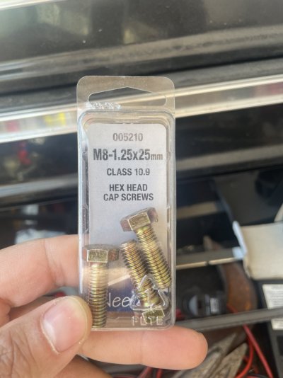

Pass on the arp bolts they were too long for my afe’s. Or at least buy them from Amazon so you can return.
The bolts that came with my afe’s are 10.9… if not autozone has them. They’re m8x1.25x25 I believe. Search my posts to confirm.

So I don’t have any bolts. Therefore I gotta order some. I’ve seen a couple posts about ARP not always fitting based on header brand (as mentioned a few posts ago). So my options seem:
1.) contact AFE for a new set of bolts (unsure of cost)
2.) use stage 8 but toss clips in garbage
3.) SRT bolts
Does anyone know if these are the correct SRT bolts? Or does anyone have part number to confirm

Those look like they’re for the stock cast manifold. The flange on them is at least 5/8” - 3/4” thick. The afe flange is probable 3/8”-1/2.”
As I mentioned ace hardware, auto zone, oreilys, advanced all have the bolts needed.
Here’s a pic - these are exactly the same length and grade as what comes with the afe shorties.
The 6.1's only ever came with the SRT manifolds as they only put them in the SRT cars ,and SRT Jeeps,the 6.1 never had cast iron exhaust manifolds
The 6.1 bolts in his link will work,and should have a smaller socket head,which makes shorties a bit easier to install

I find it hard to believe ARP won’t fit and can’t be found in stock somewhere. I put them on my eBay shorty headers. Did you try summit? They are in stock.
Aftermarket flange even on the AFe is 3/8” probably. Stock manifold is more than 1”.
