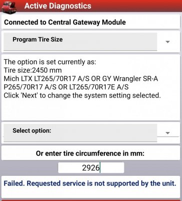

So guys I need help just got the odblink MX+ literally only bought it cause my speedo is 10-15mph off was trying to change the size and I am getting the message it failed ...any help ...seen here that people have done it before
I have a 2012 Ram 3500 4x4 diesel on 37s

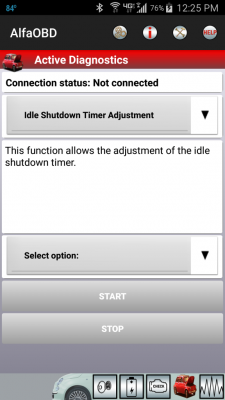

2012 Ram 2500 Cummins. Is there a time limit to how long this truck will idle and is it changed with the Alpha OBD. My son has left his truck idling and locked while he was in the store to keep dogs cool, he has had it shut down twice, once while he was stand talking to someone close enough for him to hear it shut down.

Went into Alpha OBD in my phone and found "Idle Shutdown Option" goes from 5 minutes to 60 Minutes so I think we can fix him up!!!!!

Screenshot_2020-08-24-12-25-48.png Screen shot of page in AlphaObd.

If I remember correctly, that will automatically shut the truck off if it idle for that set amount of time. The time to shutdown for the remote start is separate from that, pretty sure that value won't change the remote start. Most are programmed to turn off after 15 minutes. But you could try it.
