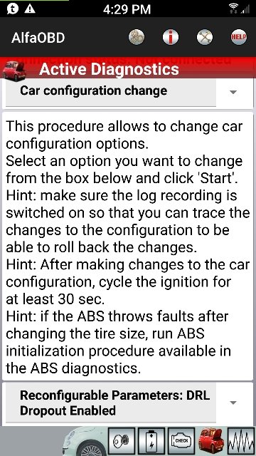

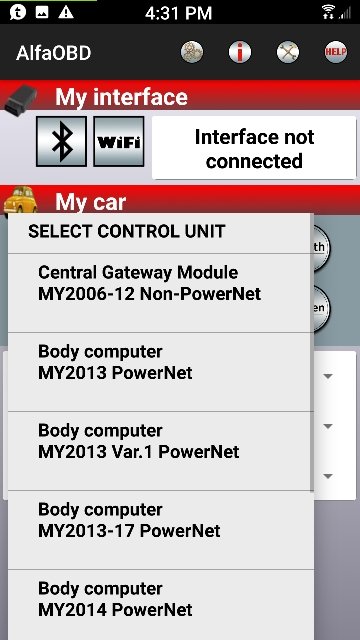

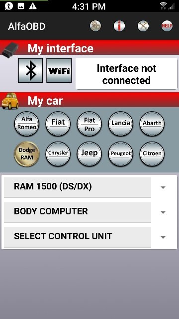

I believe this is what you need for DRL dropout...select the My2006-2012 option at the top of the list to connect.
1c97dfdb28d4b71d70c443462fc14210.jpgd34815287d41c7eae64530cd6f503ca9.jpg09af30fcdc1e809a55f546a2bd0d5650.jpg
I was able to get into things and change most of what I wanted right out of the gate. The DRL disable was a huge thing for me. Being a Canada truck it had low beam DRLs. I have HIDs. No bueno. So I had been driving around for months with my e brake down a click and it would ding anytime I exceeded 5mph from below that. Ridiculously annoying.
