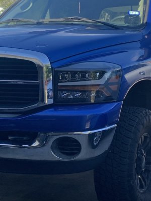

Greeting from Texas! So i have read every comment on this thread, there is alot of great info. I have a 09 Cummins that i just put Alpha Owls in the front, Spyder LEDs in the rear, & Spyder 3rd brake light. I think i finally got the headlights correct to were they dont blink at me anymore. However i cant seem to get the DRLs to act right. Plus i have the hyperflash on the turn signals.
I think one of the main issues is the obd reader i am using. I did order the MX+ off of Amazon yesterday & hope this will help with my interface better.
i set the drls to canada & selected turn signals. These alphas i bought have a drl built into them but i tried ti select it & nothing happened. Also unlike the newer gen 4’s there is no where to select leds(which means i may have to run resistors unless i missed something). I could not get the tpms light to go out either.
i will try again tomorrow when i have the mx+, i hope this will fix it. Any info you all might have would be great. Thank you!
