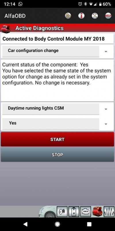

Were you able to find this setting (Daytime Running Lights CSM) in your car configuration list?e3317dbed239a5dd7ff9c3072c146e83.jpg

You know, I saw a ****load of CSM settings in there, and I'll bet I scrolled right past it while I was hell bent trying to find the other ones.
BRB, going out to check.

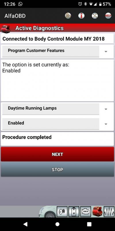

This is what I've got, and DRLs are indeed working. d497749ac828afc60a2d909ab162e1b9.jpgd6a6c88ca9b7ca38f7cb95c0415c7324.jpg

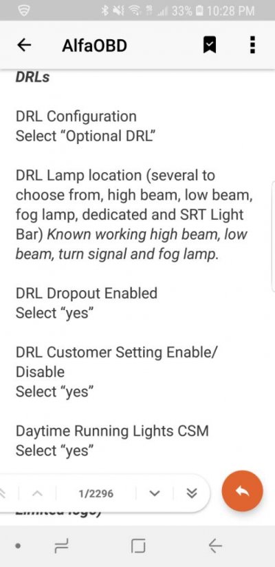

Just found this one as well. Maybe this one was the missing link. 14bf64c7fc0f8be542926d10d2d1a6e7.jpg

Yes that may be your problem. These are the codes necessary for the DRL's. Make sure you give it some time to show up on your screen. 34d05f692a78b8cce1351bdbc79e780b.jpg

Also I see you have a UAQ radio. It takes quite a bit of time for options to show up on the screen with these radios when they read your BCM so definitely give it a day or so.
