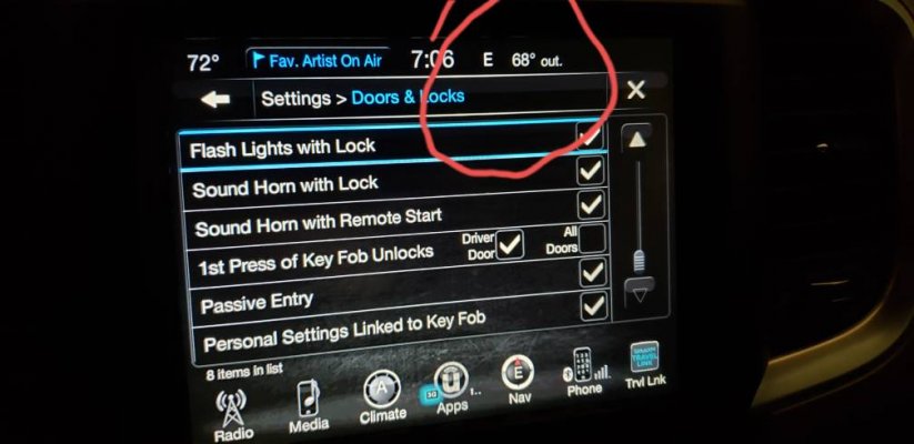

You mean like this?
... 18 Laramie CC with UAQ (factory UAS).
M² Mods.

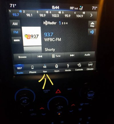

We are referring to the compass heading on the top of the radio on the RA3 RA4 radios next to the outside temp as well as in the Nav icon. The UAS/UAQ radios do not show the compass heading on the top of the screen. 658e6fa1e6e53f02fdac6f1512e05ede.jpg
My assumption is that is kinda redundant because if you look at the actual Nav icon it tells you the same thing.
