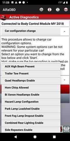

Do we have a comprehensive list of what all the options in the BCM pages are?
Some are pretty self explanatory, i.e. "Child Display Feature Present" is the dash warning to check the backseat for your kid.
However things like "Police Lighting Feature" are any ones best guess. (Granted we know what this does for the most part but is still a good example since we don't know everything that it does)

@TX_Storm_Wagon Currently no, there is not a list of all the different settings in the BCM and exactly what they do. There are still a few that I believe no one knows what exactly they do. You have to remember there are setting in Alfa that have nothing to do with Rams. Alfa applies to all FCA vehicles.
Good rule of thumb, if you're not sure then ask or simply move on from it. We have had members go through a lot trying to get their vehicles back to stock config after selecting something they were not sure of. The police lighting feature if memory serves me correctly was one of them.
If someone wants to take on the daunting task of fully identifying every setting we see in the BCM then by all means, please. Lol

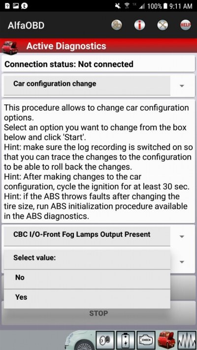

Anyone that's added Foglights/wiring and enabled via AlfaOBD vs dealer care to confirm the AlfaOBD settings used and I will update the Foglight harness install thread ? (Since I used AE tool previously).
- DIY: Add 2013-2018 OEM Foglight Wiring.
I believe the related sections should match in AlfaOBD but I might have the lingo mixed up...
Enable Foglights:
- "Ecu Config 01 - CBC Configurable Inputs/Outputs".
>> "Front Fog Lamps Output Present" = SET/YES
Fogs ON with high beams:
- "Ecu Config 02 - CBC Features"
>> "Front Fog Lamp Dropout Enable" = NOT SET/NO

I have enabled fogs with alphaobd. I don't have alphaobd in front of me but had these screen shots saved and am pretty sure this was all that I did

Thanks!
Updated the Foglight thread....
- Post 15-16: AlfaOBD & AE Tool Foglight Programming notes (vs Dealer Activation)
