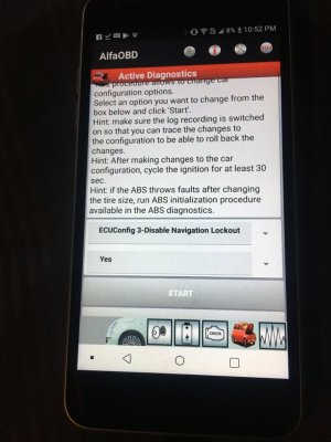

Has anybody disable the navigation lock out
This allow you to use navigation
Inmotion
crash68
ACME product engineer
Mar 20, 2016
12,342
21,458
3.0 EcoDiesel
Inmotion
Somebody asks this about everyother week, It does not work.
If you want to input to the useless navigation while driving, look into one of the Jailbreak/Lockpick solutions.
