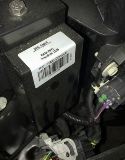

Hi ;)
I just failed to activate DRL on my 2017 RAM.
Factory setting were :
DRL Configuration: Optional DRL
DRL Lamp Location: NONE
So I changed them to :
DRL Lamp Location: Turn Signal DRL
Now, DRL are activated on my front turn signal but with full power ( probably 12V instead of the 7V ), and when I activate my turn signal I receive a error message from EVIC saying my REAR turn signal bulb is out .
I believe the problem is coming this LCM module.
I've got this because here in France as you probably know, rear brake and turn lights are separate. I think this module was added for this french conversion.
David.

Hi ;)
David.
With that module, when you have your turn signals set as DRLs, do your rear turn signals come on as DRLs also?

Hi Jimmy ,
this is very good question !
Unfortunately I didn't check but you have probably the same idea that came to me : This module maybe use the front turn signal to light on the rear bulb. This is a method often use here to convert a US car to the french regulation.
I will have to turn on again DRL with alfaobd and check.

Hi Jimmy ,
Also, do you have factory projector headlights, or the quad headlights?

In that case, set your DRLs to these settings instead:
DRL configuration >optional
DRL lamp location > dedicated
DRL dropout enabled > yes
CBC I/O right dedicated DRL lamp output present> yes (should be yes already)
CBC I/O left dedicated DRL lamp output present > yes (should be yes already)
LED dedicated DRL present> yes
ECUConfig 3 DRL customer setting enable> yes
CustSetMenu 1 daytime running lights CSM> yes
