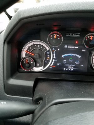

Buddy installed a premium cluster and lost his fuel economy page...
Anyone else have this? Should I Be able to reinstall it.

Hey guys..
Sent from my SM-G965W using Tapatalk
Never saw that issue before, you mean this display?

Did it ever have it on the 7 inch after you installed it? What year is your truck and what year is the evic? What radio do you have, may be able to select it, check box it there....

Not sure the year it came from or if it had it.. it came from a power wagon.
The truck is a 2017 with 5" uconnect.
The EVIC shows "fuel economy" but just a blank screen as u can see.
My guess it just need to think about it for a bit

The reason I ask is I had problems, and so did alot of others with the nav next turn not showing ,just a blank screen just like your showing for fuel economy, I had to switch out evic to another one...

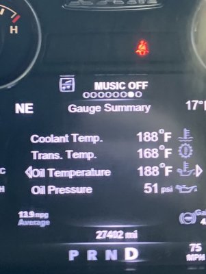

Own a 2018 2500 diesel cluster. Mileage, engine hours, and idle hours all reset fine. The radio is an 8.4 without Navi. At the top of the cluster it says Music off. Is there a feature or a flash for radio I need to perform as well? Photo of issue is below Adjustments.jpg

I would say go into your 8.4 radio and check under settings and see what's checked marked..first,also go into your scroll menu on evic on left, there are settings options there as well,seems like a setting is not enabled..

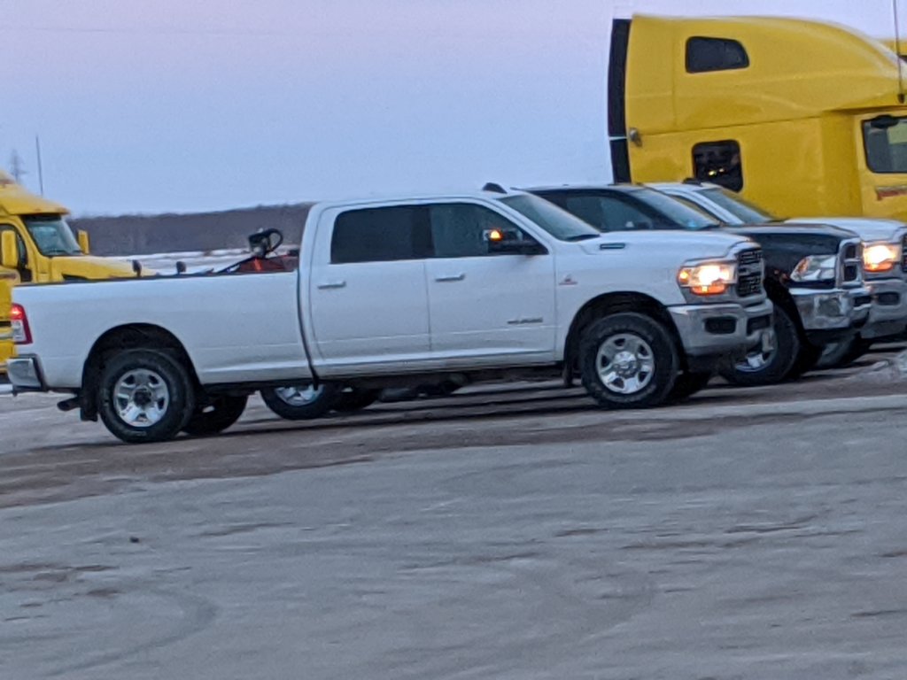

I don’t know how this works but interested in what someone says....I have the tow mirrors and would love for them to act as blinkers and running lights/parking lights....is that possible?
2018 Ram 2500 Tradesman
6.7L, G56[/QUOTE]
at work today we had a bunch of 2020 5th gen RAM 2500 tradesman with the tow mirrors and they lit up like running lights NOT turn lights
do not know if they do BOTH OR running / clearance only
