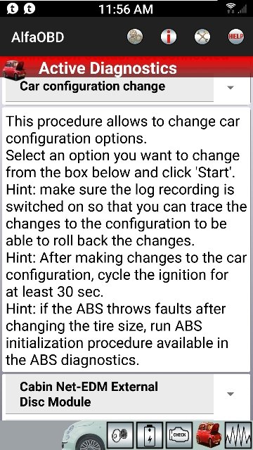

So I am new AlphaODB junkie and my first change this past weekend was DRL on the turn signals. Woohoo!
While going through some of the options I saw one that caught my attention so tonight I enabled it and to my disappointment, it did not work.
I do remember seeing posts a while back that guys were making their mirror turn signals into side marker lights. This option does not do it. Anyone know if we can do it on 1500 without tow mirrors?ac8f75201ef8b32c5f4783cd4953e842.jpg

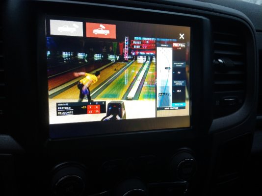

I'm trying to perfect what I'm calling AlfaOBD TV (poor man's LockPick)
Couple of questions, for anyone with a factory CD player, how is the Audio accessed through the radio? Is their a button on screen?
Assuming there is a button on screen, does anyone know the settings in Alfa to add that soft button to the radio?
I don't have the CD player but I think there is a CD player icon/button on the bottom of the screen instead of a "media" button.

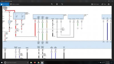

Not sure if this will help you but here is the wiring for it. (you may already have it)
Thanks! I did find where I'll hijack the CD player left/right audio signal. Now I just need a way to select it on the radio.
Presently I'm using the left/right AUX channels, but I'd like to use the CD Player audio since I don't have a CD player. I think most people would find this useful too as most don't have a CD player.
