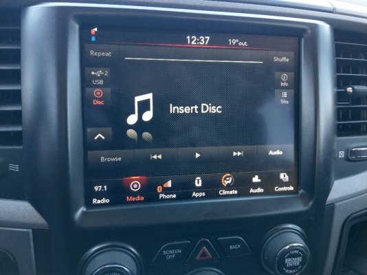

Closest guess I have is this...I may just give it a try and hope for the best.
Just saw that myself. I also found this in my log but can't find the setting in Alfa yet....
ECU Configuration 3:
External Port Type: AUX + USB + SD
Wonder if there is another option available that has CD? Those are the 3 options available under the media menu.

Good info. I saw that setting but who would have thought enabling the "eject CD" would give you the button.

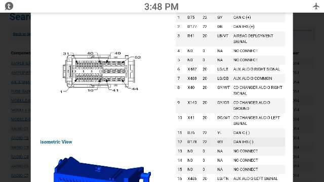

I actually looked there first because that is how you get all of those buttons to appear on the radio based on the hub in your center console.
Unfortunately it's everything BUT the CD player!

I'm hoping as long as I have "something" connected it will display the button.
I'm going to take an edumacated guess that the audio ports won't establish meaningful communication for the CD icon to show up on the radio. The radio will probably be looking for something on the other wires that would come from the CD player.
Maybe, I'm only guessing right now as they are labeled generally the same and pinned generally the same as the AUX left/right inputs.

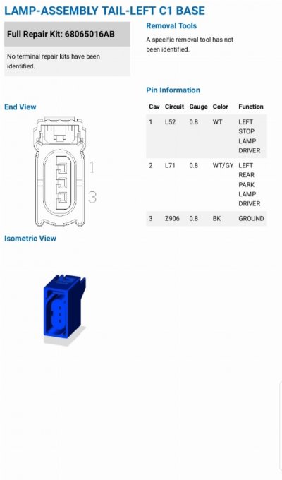

Just got the alfaobd going for my 2014 sport with factory led tail lights. I’ve been trying to disable rear turn signal dtc monitoring to get rid of the “ rear left turn signal out” evic message. Got several other features to work. Does anyone know if there is even an option for this? I can’t Stand the dinging every time I hit my brakes anymore. Ready to to trade this thing in already.
chrisbh17
Oct 12, 2017
6,720
7,525
Not sure that's an option on the 2014......I think it started in 2015.
Your best bet is probably a load resistor.
I did read there might be a wire that you can jump to ground that might do the same as the Alfa option, but it's unclear if it is on a 1500 (the reference I found talks mostly about 2500 and higher)

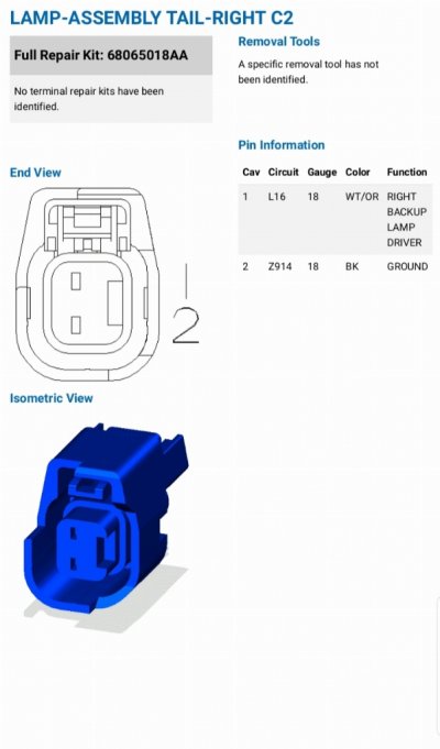

Chrisbh17, thanks for the input. I was thinking of adding a load resistor also. Not sure which color wire goes to the left rear turn signal. Does anybody have a tail light wire diagram or color code. Thanks again
Left and right.
Premium and base.
2014 RAM 1500:

Diboblo, you guys are awesome! Thanks so much. Got a couple load resistors on the way. Will keep posted if it helps.
Victory! Now I just need to swap pins and see if it plays audio...
