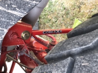

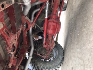

C74F9258-F082-414A-B081-9469C5C88812.jpeg 2D910521-56AD-4871-AE5A-8AD84506F27D.jpeg 79647E2C-B022-4B93-AFFD-7AC4863A8036.jpeg
Let's see yer rig my friend!
Sent from my SM-T387V using Tapatalk
Here is some I have. I noticed I don’t have any of after my Hellwig was installed. I’ll have to grab one of the whole back end once my truck arrives back into isolation next Thursday.

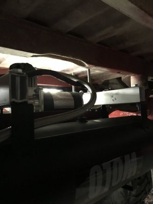

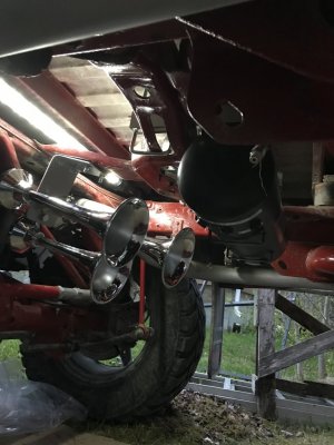

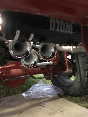

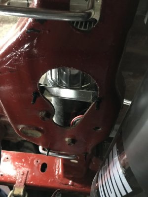

476F9BB9-1C52-4A36-A267-7BC4B8C64275.jpeg DF7A7A85-43CD-4219-89C6-2FA3CF5DA9E4.jpeg 9119B483-1B39-4BDD-AB84-6AF80D2DC382.jpeg 0590ABC6-DB97-4815-942F-01999BAC8AC6.jpeg The train horns are the Wolo Cannon Ball Express Pro. Very easy install. I done away with the spare (37s) and fabbed up 2 brackets to hold the train horns to the spare tire mount. The compressor (Tornado) is sitting on top of the spare tire cross member and drilled/bolted down. The horns are bolted to the cross member going from axel frame to spare tire frame. They are pretty damn loud. I have the compressor running to a switch in the cab and obviously the horns to it’s own button. I have it so the horns can be used when the trick is off (my preference).

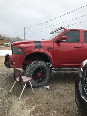

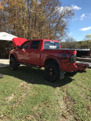

6” Fabtech lift, 3” Daystar BL and 37/13.50/20 AMP mud attacks on 20x12.5 Moto Metal rims. Plus 2” Supreme Suspension wheel spacers.9C6A3194-62C1-4D54-B0E5-FCC1578FCB12.jpeg FE4F07DB-A294-4624-A5CD-73C560CE167A.jpeg 71BF6ADA-94B8-495B-B3DF-42C7F2B66898.jpeg

I saw the brackets on the rear of the truck wondering what it was for in a different pic. Thank you for the info!
I'll have to look into finding the parts in the future although I can tell you now my horns are going satin black to hide them.
Could always install one horn on each exhaust cutout :eek::D. Then reroute the exhaust to side exit.

Are you talking about those aluminum brackets on the spare tire crossmember? If so, those are what I made to hold the air tank. Sorry I didn’t mention that if that is what you are talking about.
I was going to paint them black as well, however was in a rush to get them installed before I sent my truck out of isolation. I still may paint them as they just hanging there.
